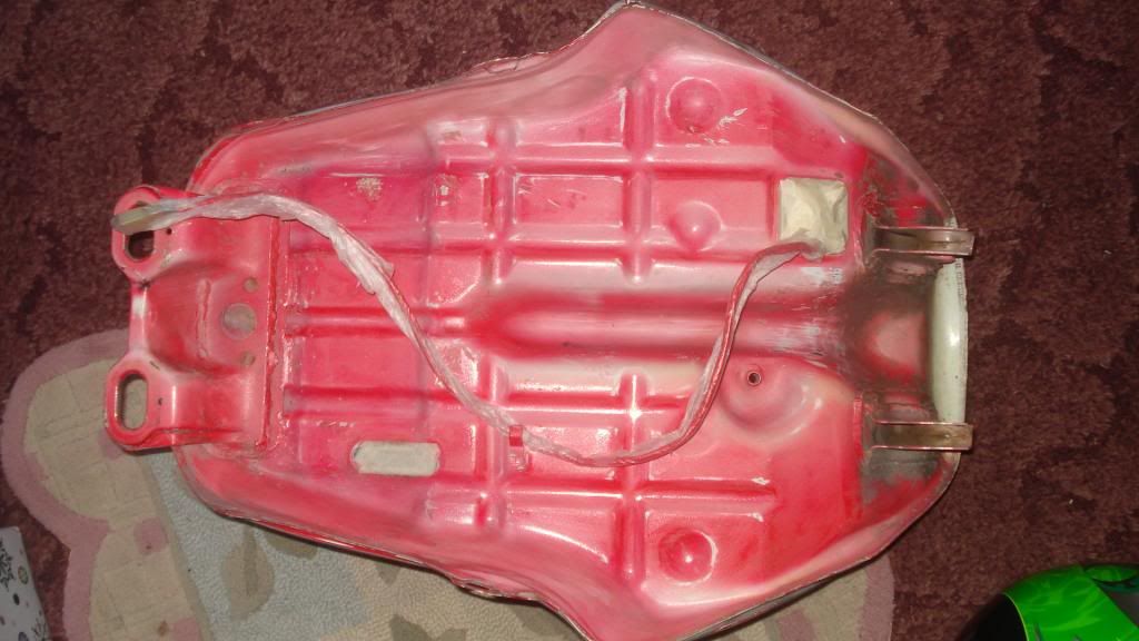

Still waiting for my paint job. I had time to get the bottom of the tank prep'd. Wasn't going to bother with the bottom because of trying to reglue the heat shield back on but I guess I'll try contact cement. I got my petcock all ready. Epoxyed the elbow in and cleaned the inside. Everything looks good. I can pull a slight amount of air by causing a suction on the vacumm tube but very little. I wired it up and ready to bolt in.
Just waiting for my son to get his bike painted. (popcorn)
You Keep What you kill

Quote from: Joe Sull on February 20, 2014, 03:58:08 PM
Man, you really do go all the way out, don't you? Doing red underneath the tank as well!?! Cudos to you man, cudos....  :good:
I to need to reglue my heatsheild... After my fuel leak had been laying a couple of days I guess the fumes must have dissolved the old clue.. Everything could just peel off...
I will not be painting it blue underneath though  :biggrin:

Quote from: keand3 on February 21, 2014, 12:22:40 PM
Leaving it red as a tribute to Joe's bike, then?

Joe Sull
You can see my bike was red in the begining. Now it's red all over, more than anywhere else. :biggrin: Red is'nt really my favorite color it's just that theres so much beauty in the engine area and it was covered with black. I came very close to doing the whole thing with the metalcast green and the body candy apple green.
I no one thing though - I gotta keep you guys guess'n :lol:
