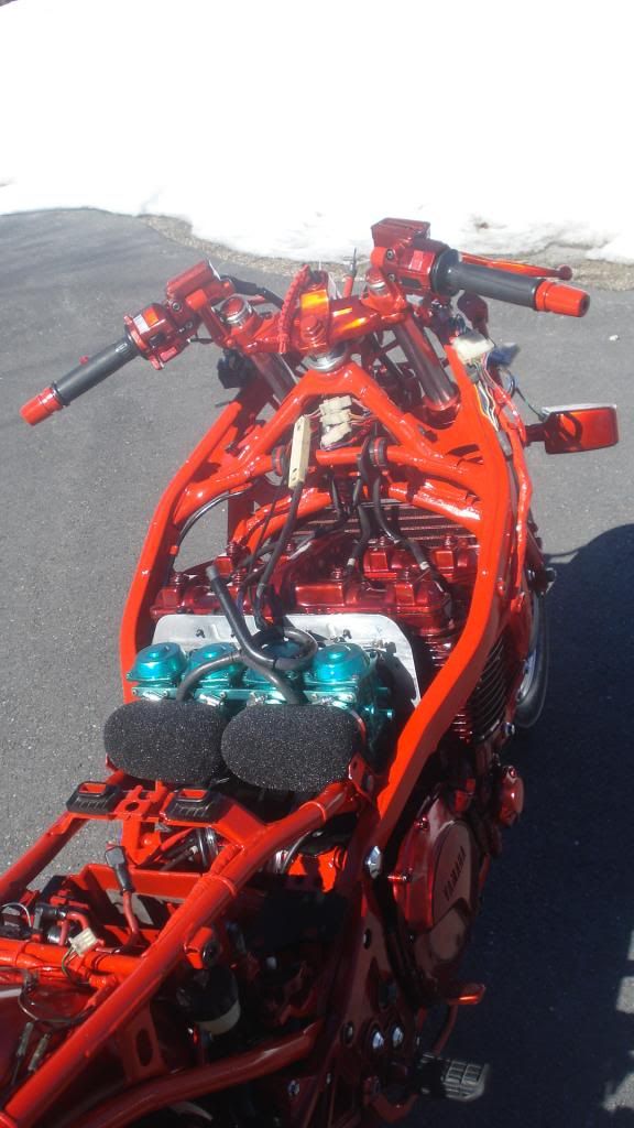

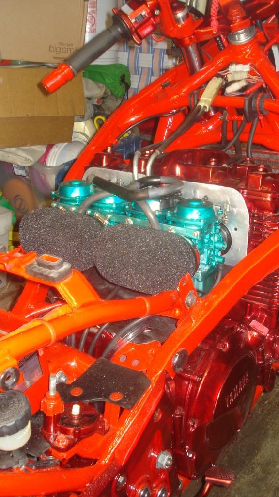

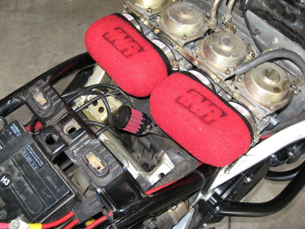

Got new uni-pod from RPM. Man, those thing look like they belong there. Very pleasing to the eye. "eye candy" is that right?
The little wire  fuel line hose clamp tang thingys kind of interfere with the filter flange. I'll turn them around or replace them with something
more trustworthy.

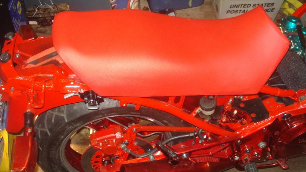

Hung the seat on for giggles.

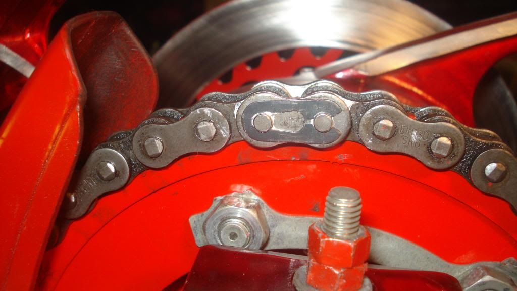

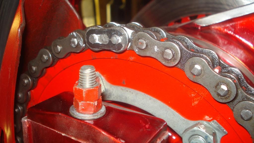

I installed the new master link and I wish that I had assembled it before hand. The clip doesn't look like other pics of a properly installed clip.
For the third time, I've tried to sink the clip into the groove and it doesn't seem like it's going in any further.
I saw a thread and pics of a safety wired clip and I'll do that when I find some proper st st wire.
Does the clip look right? It's a EK 530 SRO-z master link

Pretty sure you can get the UNI filters in RED too!   :sarcastic:
Awesome job staying true to the theme

Make sure the rounded edge of the clip (one side will be rounded the other sharp) is against the chain side.  Personally I have never really trusted master link clips and prefer to go with the 'peen on' style.

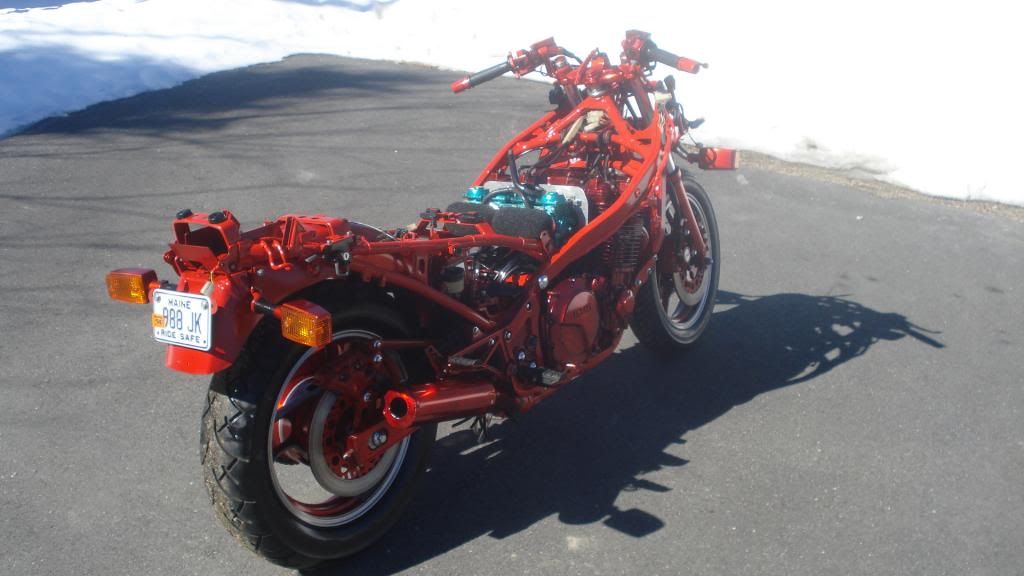

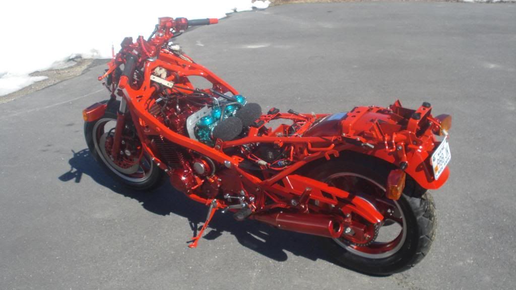

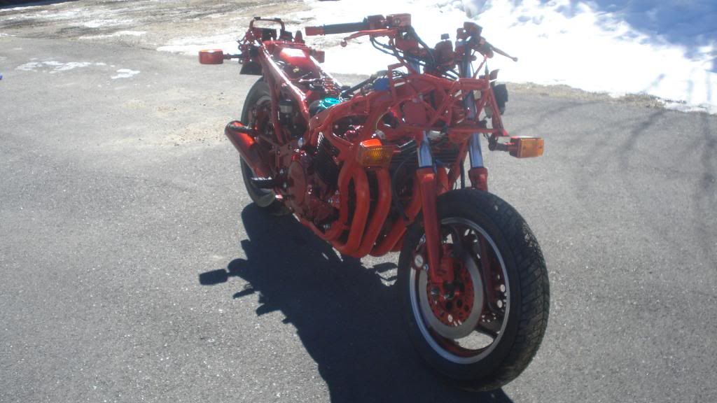

Pushed the bike up front, on the pavement and it just melted the snow and dried it right off. :biggrin:
Saturated her with polymer. Put a sprayer nozzle on the bottle and she was dripping wet, then I wiped it down.
Rolled her back in the shop and put a fresh battery in, set up the fuel funnel and started it. Ran it till no more paint
smoked. she was pretty hot. The engine don't burn any smoke at all, I'm happy to say.
I used my fancy new home made sync tool and sync'd the carbs. The top end is very quiet, no tapping or noises of any kind.
She ready. I gotta get my stuff painted :sorry:

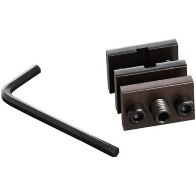

The side plate needs to be compressed a little more for the clip to drop in. I used master links till last year and to get the clip on I used a compression tool to set the side plate. Looks kind of like this:
master link press tool
Joe Sull
Thanks Monkey, nother tool I can't afford :lol: You buy a chain that uses clip style master links to get away from buying a swaging tool but you end up having to buy a tool to compress a clip master :wacko3:
It doesn't look completely down compared to some pics I've seen with the two inside edges of the clip touching and that would make the clip in a relaxed state. I'll try again!

You seem handy with tools, needle nose vise-grips will work in a pinch. Just make sure the jaw is on the pin on the back side and the other jaw is on the plate. This makes sure that only the plate you want to move is the one moving.
