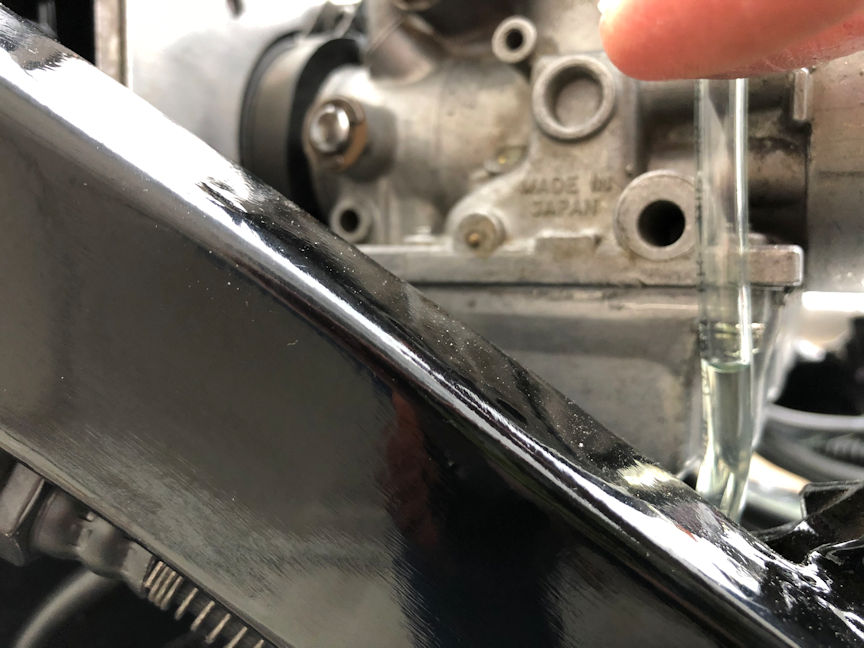

It can only leak through the tube if fuel level inside keeps rising, which means float needle is not seating or it is set too high/low, which it isn't because you checked it and it was below with the clear tube.
Quote from: stou on January 30, 2020, 09:21:52 PM
No I didn't replace those o'rings. But it was leaking through the tube, not by the plastic connector. Everything was nice and dry when I checked the level on the bench.
Mine were fine until I moved those tubes, sitting on bench they were dry too..
Do it, replace those o rings, it'll be 1 more thing off the list of possibilities  :flag_of_truce:

Yes I'll replace those o'rings. Like you wrote, it's better to do it while I'm there. The only reason I can see for the leaking is the level is probably at the higher limit on the bench. When I installed them on the bike, with the 6° angle and probably not on level on the driveway, that make them leak.

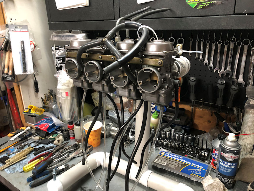

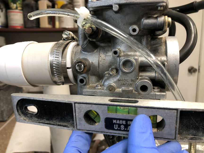

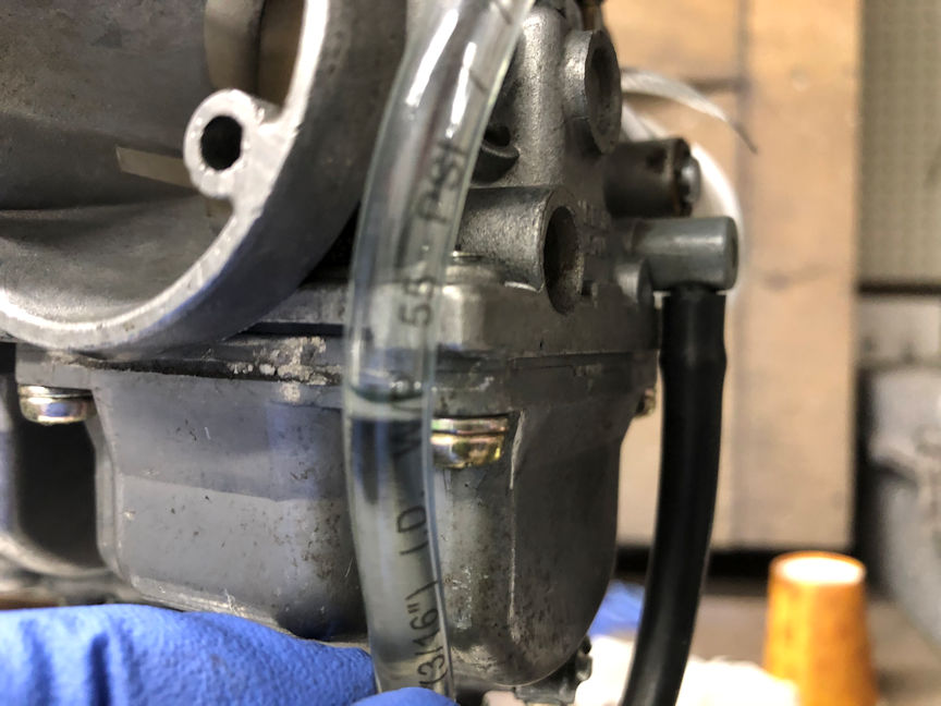

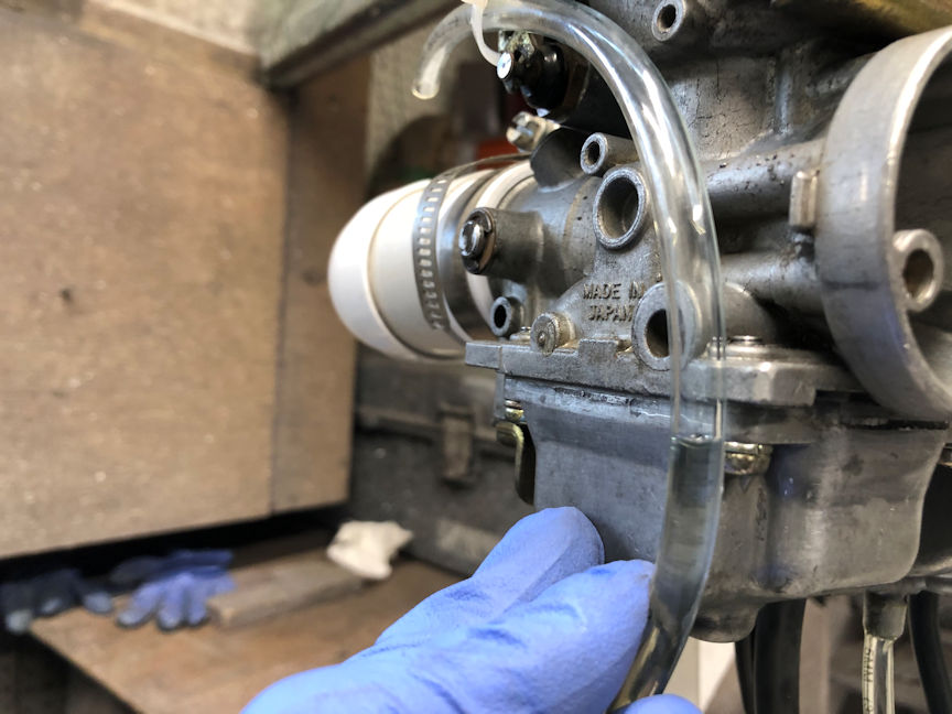

Yesterday I did the floats adjustment once more. I did it at level and then checked at 6° to see how it look like. The level is lower at 6°. When I verified them again today, #1 and #3 was ok, #2 a little bit high and curiously, the #4 was very high. I readjusted #2 and then start to work on #4. On 1, 2 and 3, the tongue hight of the float was between 2.20 and 2.40mm high. The #4 was at 2.45 from the last adjustment, but leaking. I started to rise it and after many time it was looking
My setup
At level
Carb #1 and #4 at level on the bench

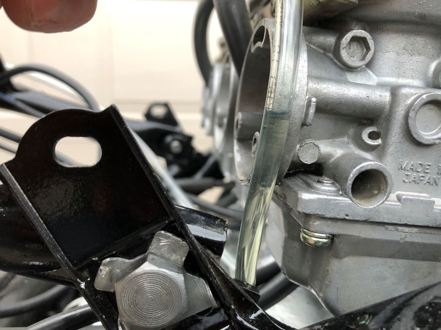

Today I installed the carbs on the bike and get it out to start it. The bike was running not too bad but the #4 started to leak again... WHAT!!!
I checked the level on the bike. #1,2 and 3 was a little bit lower due to the 6° angle. But the #4 was high as hell! :mad: :diablo:
The only reason I can see, is there's a problem with the needle. They are all brand new, but there's something bad with the needle or the seat and it doesn't stop fuel to enter in the carb.
|1, 2 and 3 are like that on the bike
But #4  :shok:

Yesterday afternoon I attacked the #4! I removed the needle and seat to make sure the o'ring was ok. It was ok but I found a bit of dirt inside the seat, maybe something in my new auxiliary tank. So I cleaned it carefuly, I installed a fuel filter on the line from the auxiliary tank. I tested the needle and seat alone, and it work fine. I also used another float to be sure the float is not the problem. I did a first bench test and it leaked. I lifted the tab a little bit more and did some test a few times. It finaly work fine when the tab was at 3.25mm. It's stange compared to the other carbs which are lower. Maybe the seat of this one is borred deeper than the other.
