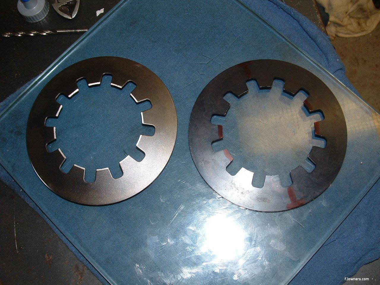

         I got the aforementioned EBC spring tonight when I got home. I have yet to give a full comparison to the O.E. unit, but by first impressions I probably won't be buying another one. I am not sure if they are distorting the spring to give it the advertised 15% better clamping force, but this thing is bent...
I will do some measuring tomorrow when I get to the shop and include some pictures of the obvious things I see by holding it in my hand.
I am not impressed and it doesn't look to good up to this point; more to follow.
Testing is complete and I can say that the one EBC I received does not match the performance of a new diaphragm spring, and out performed three used springs by just 1.03%. Each spring was cycled two times prior to taking a reading. Each spring/combination was rated three times and each rating was consistant. I checked each spring and combination from zero to over-center for maximum clamping force.
I tested three new Yamaha springs and the tested; 289, 291, 288 lbs.
I tested three used Yamaha springs and the rated; 250, 251, 250 lbs.
The EBC spring rated; 259 lbs.
Two new Yamaha springs doubled up rated; 581lbs.
New Yamaha and used Yamaha spring; 556lbs
New Yamaha & EBC spring; 553lbs.
Used Yamaha & EBC spring; 513lbs.
See pictures and captions;
Yamaha spring on the left, EBC on the right
Stock Yamaha spring, with center fingers machine ground flat to match spring retainer plate angle.
EBC Spring. Outer red "T" markings on outer edge of spring are the two contact points against that flat glass plate. The two red fingers on either side 90* to the "T" marks are the high point with the center of the kink between the center of the two fingers. The distance of the warpage of the spring is an equal .030 on each as show by the two feeler gauges.
Close up of .030 feeler gauge placed into kink of EBC Spring.
The quality difference of the two springs are as listed;
Yamaha:
Stamped manufacturing process.
Shot peened and heat treated finish.
Angle ground fingers to match angle of retaining plate.
Consistant measurements within factory specification.
EBC:
Plasma cutting manufacturing process (rough edges).
No shot peening of the spring before or after heat treating.
Spring has "kink" which allows a .030 feeler gauge to fit under each side of the spring.
Same .030 difference on the finger side of the spring.
Yamaha maximum spec for spring warpage at the base is .004.The EBC measures .030 on each side.
The minimum finger height spec is .240. The EBC spring measures .280 on the low side and .310 on the high side. The Yamaha spring measure .270 equally on all fingers.
Like someone said in an earlier post it might make a sufficient additional double spring. It might even be easier to compress due the reduced clamping pressure. If someone wants to try it as the secondary spring let me know. If after that it is determined to be an adequate spring for the double application I will consider adding them to my inventory.
If you decide to buy one to try it, make sure you install it under the factory spring so the retaining ring does not wear through from the unfinished & pointed edges of the fingers on the EBC spring.
