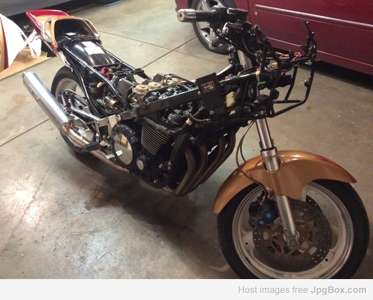

I’ve never owned a used bike before last weekend. I bought ‘em all new, before this one:

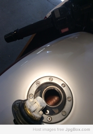

The bike will get a valve adjustment, plugs, carb sync, valve cover gasket and washers, some rewiring of added electrics (horns) hydraulic flush of everything, and a rebuild of the clutch slave. I figure the brakes and tires are good enough for this season. I’m thinking about cleaning and greasing the fork stem bearings since I’m there, and I need to think about a tank cleaning. The tank has some rust, not bad for a thirty year old bike, but, more than I want there. Electrolysis is pretty intense, I might use steel shot and solvent to work the furry rust down, and just keep an eye on it. I have to think about that.

I'd suggest a length of small cheap steel chain as an agitator, instead of steel shot.  Lots easier to get it all out, afterward.
A battery charger, metal bar,  and some mildly doctored water is not what I call intense.  It goes into places that nothing else would.  Try it on some test pieces of rusty metal in a plastic bowl, and see if you agree.  Just a thought.

Ted, I did the electrolysis thing last Christmas and it worked really well. There’s plenty of YouTube tutorials. I watched  a handful and was ready to go. A couple of hours, a few flushes, repeat over a few times and that’s it. I replaced the petcock seal and the fuel sender gasket for good measure. Easy.

What did you guys do about the float and sender in the tank?

Undid the 4 small bolts and removed it. Made a rubber seal out of bike inner tube to seal both that and the petcock hole during electrolyzing. Having this sender hole made for a great drain when flushing out the gunk.

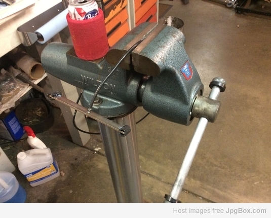

Built my anode, silver soldered a 10 gauge wire lead into my cold rolled anode, and glued split hose on each end with some RTV to keep it off the metal. Got the petcock and fuel sender out and built a cover plate for the sender hole. I’ll replace the petcock with new, but, the sender seems to be unavailable. Would be nice to replace it, but, it does work.
