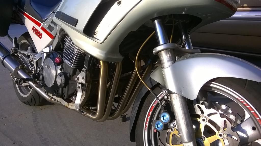

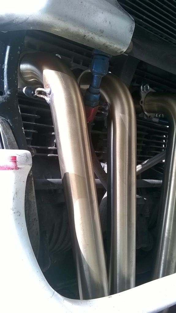

I just came across this again and the RPM S/S exhaust system is now available and the largest loss of weight for the FJ.
A full write up; In development: RPM header for FJ's
Quote from: aviationfred on October 29, 2014, 03:45:36 PM
Here is another option for exhaust. The RPM 4-2-1 exhaust system is stainless and extremely light weight. Roughly 30 pounds lighter than stock. They turn a deep gold color once they have a few heat cycles on them. I am not into the highly polished look, but I am sure the RPM head pipes would shine up real good.

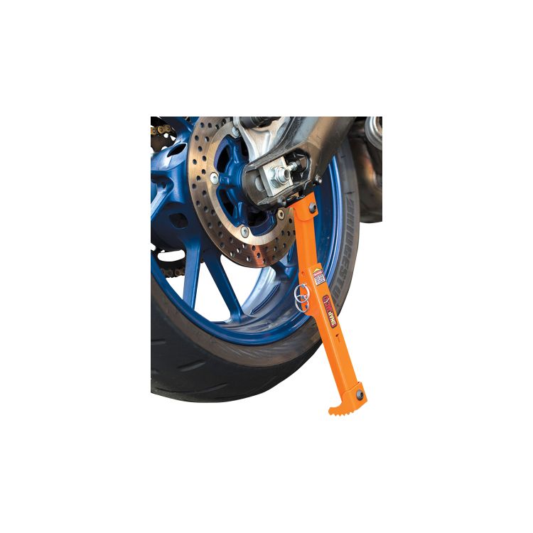

what about removing the centre stand?
Logged
'89 3CV
Global Moderator
Gold Contributor
Super Hero Member
Online Online
Gender: Male
Location: Palm Desert, CA
Posts: 8007
Re: FJ on a diet (make it lighter)
« Reply #28 on: April 26, 2019, 07:51:26 PM »
I have no center stand, so I carry this on my trips so I can lube my chain:
https://www.revzilla.com/motorcycle/tirox-snapjack-v2
