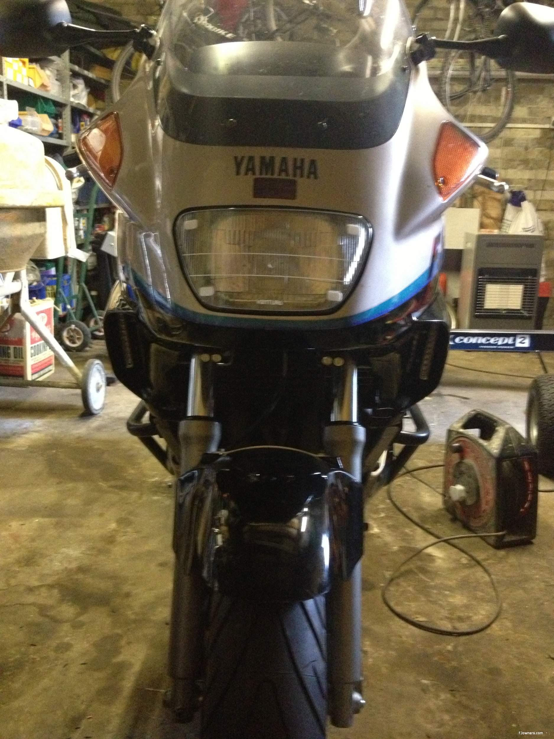

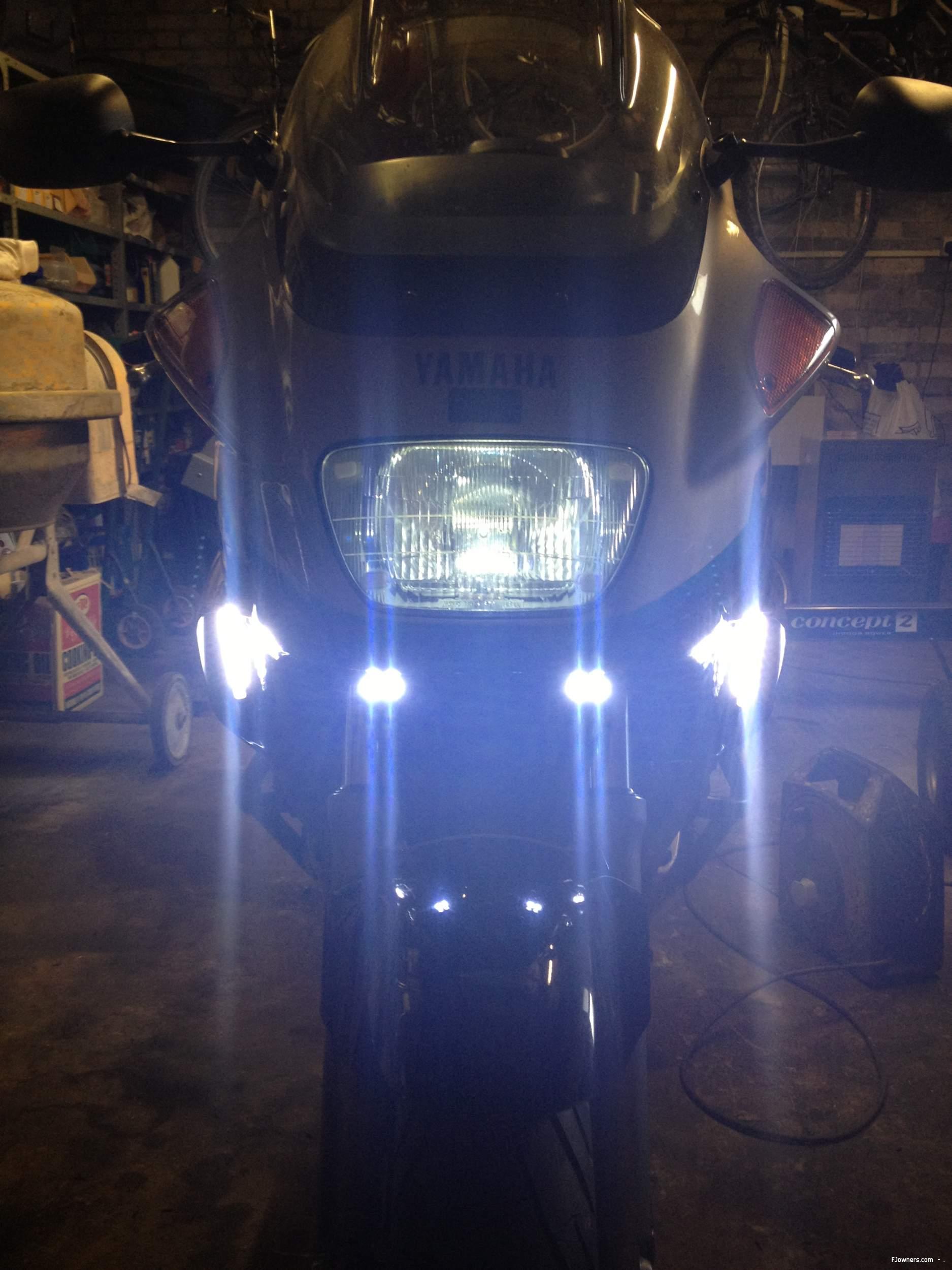

Ok folks, i previously struggled to get the RAM sccops off, but with a little gentle persuasion they came out.  Once screws are out, They have a plastic bit with an arrow profiled head that sits in a rubber housing within the frame an just needs jiggling to get it out.  Consider this though, it is essential to remove these or fitting lights these just wont happen!
I sourced the lights from this site.  www.bikevis.com  Service was good, postage was a bit overinflated (twice actual cost - as price in uk is printed on the stamp!!)  the items themeselves were ok.  The LED pods themselves can be found cheaper else where on tinternet as can some of their other items however i have not yet seen their LED bullets elsewhere, so i ordered a few bits together.

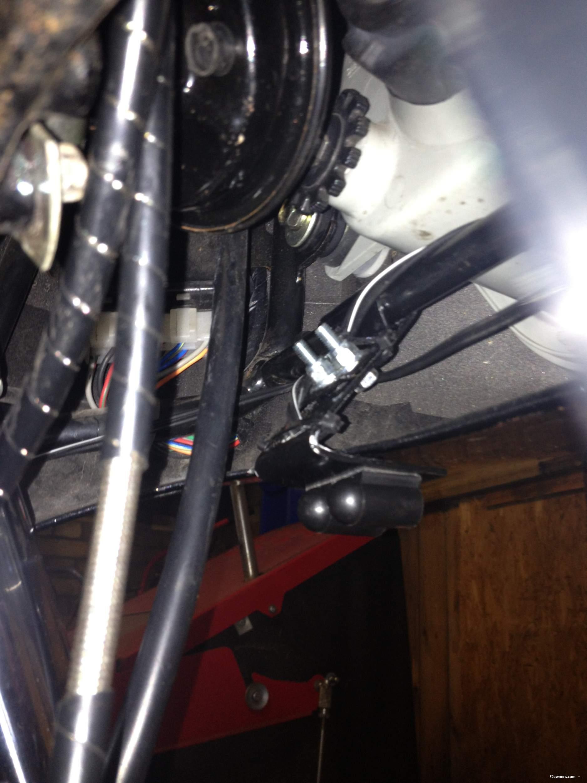

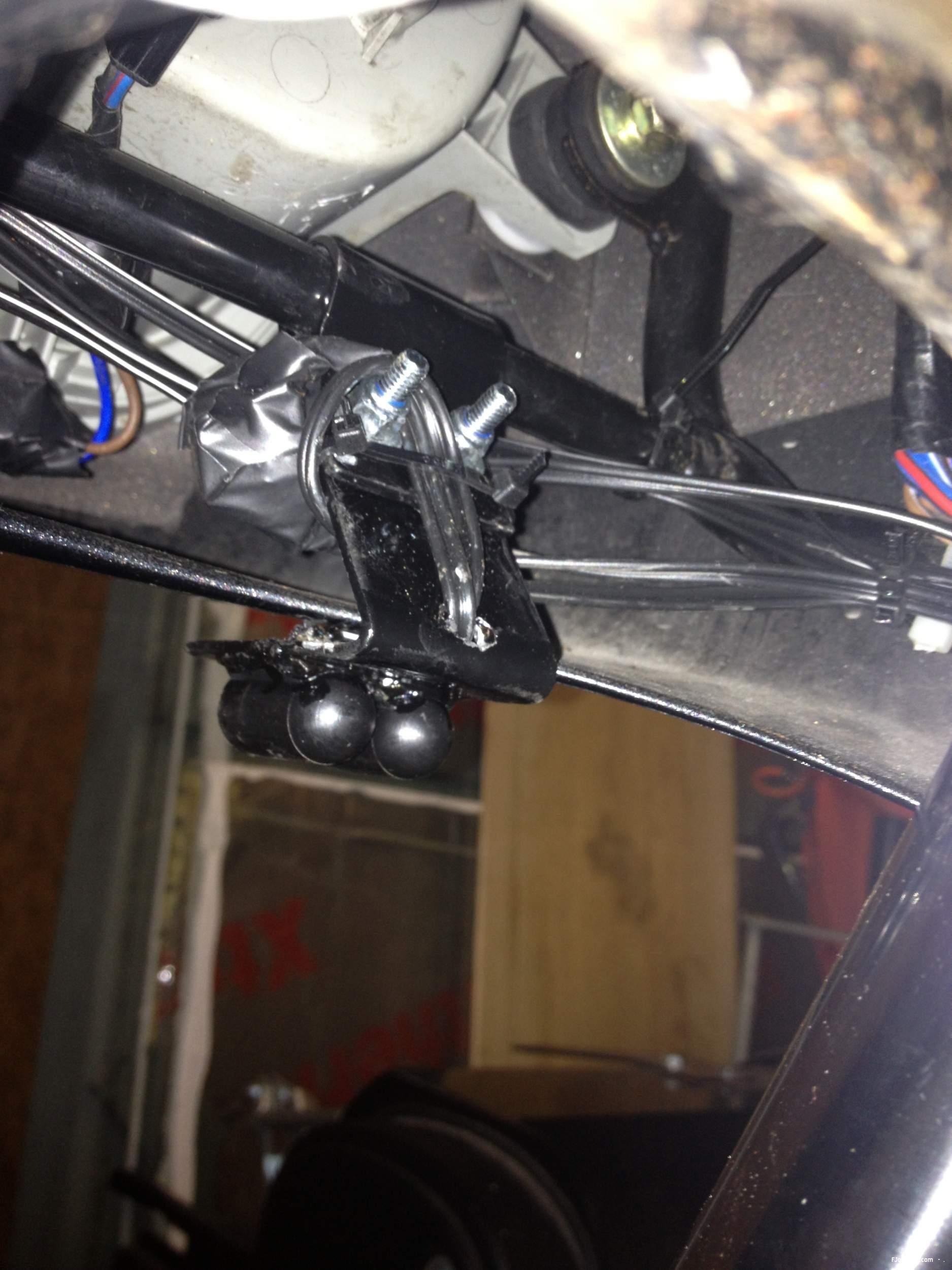

As for the install i made a couple of brackets by bending some flat aluminium (please note i have spelt and pronounced it correctly!!) and mounted the bullet LEDs to them then bolted it to the inside of the fairing frame.  The side pods were easier just a matter of measuring and drilling carefully.  What was a nightmare was running the wiring.  Its about the only time in my life i have ever wished i had small 'lady' hands.  There is not a lot of free space behind there but i made it work (after about 5 hours!! and that was without making and painting brackets).  I was advised re cautious use of solder, so i hedged my bets and used solder and connector blocks, once done i didnt fancy having to go backe and do it all again).  All worked out well, in the end.
In the end i used the Pink and brown feeds on the right hand side located just behind the Right RAM scoop (these are the permanent live feeds to the horn) to power the LEDs.  They dont use alot of juice 0.06 for the bullets and 0.12 for the pods.  Was advised it was optional to use an in line blade fuse of about one amp, but smallest i have found at local motor factors is a 3 amp, anyone think i even need the fuse at all!!
I also replaced the park light with an x5 LED small bayonet cap bulb (loads on ebay).  I wouldnt say this is brighter (in terms of Lumen) but it is a clearer/whiter light.
My aim for this was for it all to be reversible, look as close to stock as possible and not too be obtrusive.  I think i have achieved it!?!

From the cockpit, it looks ok, it lights up the garage wall in the daylight, so it's fairly bright!

I know what you mean about the grommet but the tolerance is so fine it would push the bracket down and back therefore making it foul the forks. It was also a bloody nightmare to feed the wires through there without any extra restrictions.  It is well cable tied so should have little or no movement, and u can't see it vibrating through in a hurry!
Just thinking about the fuse, if it blows whilst out I only loose the horn (so no massive loss) but I wouldn't be able to replace fuse until back home as I would need to remive the scoops.  Anyone happen to know of somewhere else easier I can pick up that brown or pink feed that is more accessible?

Nurse,
You said, "Just thinking about the fuse, if it blows whilst out I only loose the horn (so no massive loss) but I wouldn't be able to replace fuse until back home as I would need to remive the scoops.  Anyone happen to know of somewhere else easier I can pick up that brown or pink feed that is more accessible?"
The Horn and Turn Indicators are already fused with the "SIGNALS" fuse under the seat.  You could separately fuse the running lights with an additional inline fuse, but it doesn't have to be a BIG fuse.  There are some inline bladed fuses and some inline mini bladed fuse holders available at electronics components shops.  BTW  a short that blows a 1A fuse will probably also blow a 3A fuse.  The LED lights you bought are cheap enough that fusing them will not keep them from failing and it will also blow the "Signals" fuse.  With the minimal draw these lights have, if you really want to fuse them you could use a 1/2A or even a 1/4A fuse.
